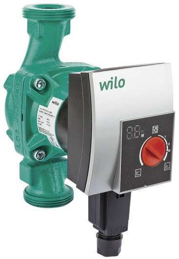

Pompa taka POMPA-WILO-obieg-do-c-o-YONOS-Pico-25-1-
