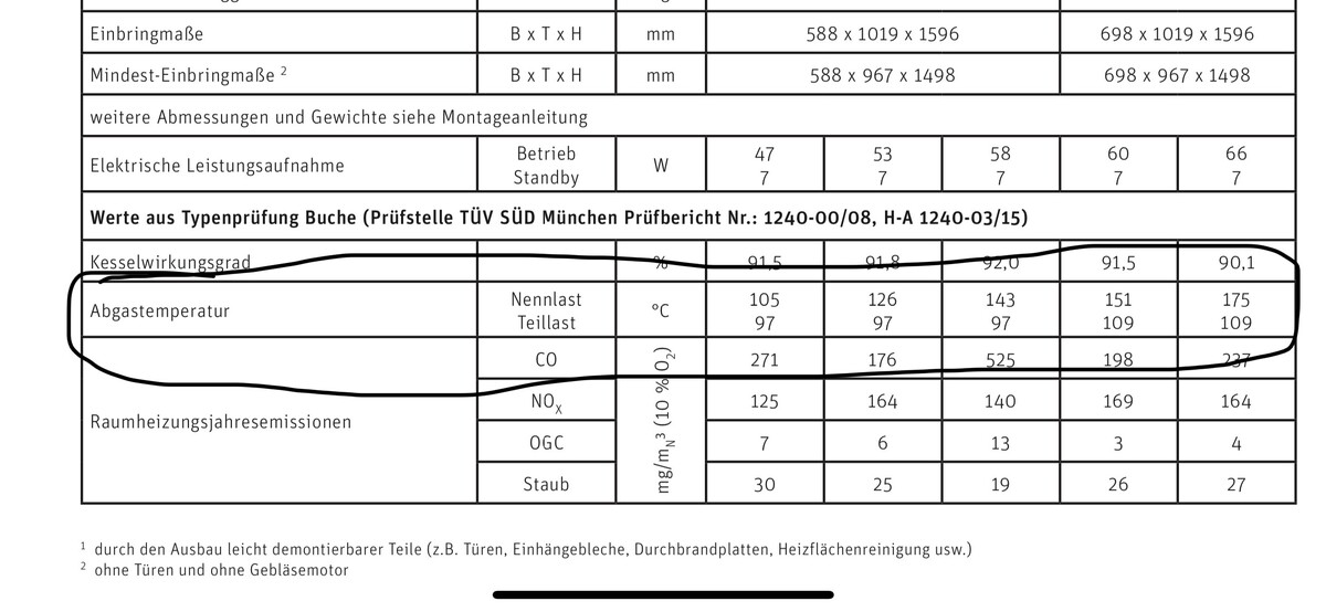

Szczegol jest wiecej w jednym jest “should be” a w drugim “recommended” Co byc moze oznacza ze przy kotlach z recznym zaladunkiem “zbiornik” musi byc a przy automatycznych juz nie. Stoking mode: [Manual: the boiler should be operated with a hot water storage tank of a volume of at least x (*1) litre/Automatic: it is recommended that the boiler be operated with a hot water storage tank of a volume of at least x (*2) litre]
